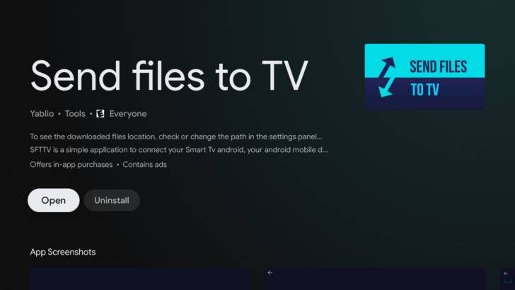

First, you'll need to install the Send files to TV app from the Play Store on your phone and TV. To install it on your TV, open the Play Store and search for the name, or click the above link on a desktop computer and set your TV as the installation target.

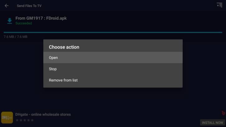

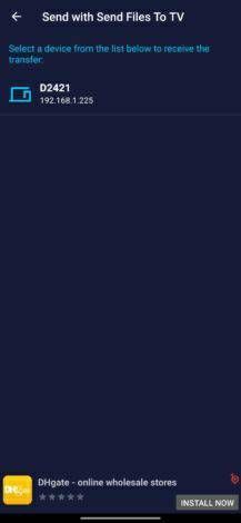

Once the app is done installing on both devices, open the Send files to TV app on your TV, then select the 'Receive' option to start the receiver. Now, open the app on your phone, and press Send. This will open a file browser — you'll need to find the APK file and select it.
Once the file transfer is done, you should be able to select the file on your TV, then press the 'Open' option. If all goes well, you should get a prompt to install the application.

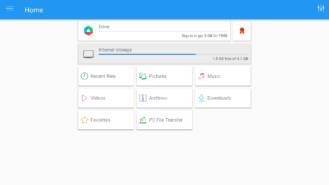

However, the transfer app seems to have an issue where the Open button doesn't always work. If that's the case, you'll need to install a separate file manager application on your TV, like File Commander. In File Commander, select 'Internal storage' on the main screen, then the Download folder. Any files you transferred using Send files to TV will appear here — just press one to open.

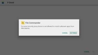

If you have a recent version of Android TV, you may get a message that installations from unknown sources are not allowed. If so, select the 'Settings' button, which will open a popup on the side with a list of allowed apps.
You just need to switch the app attempting to install the APK (either the file manager or Send files to TV) to the 'on' position, and press back on your remote to return to the installation. You only have to do this once, at least.

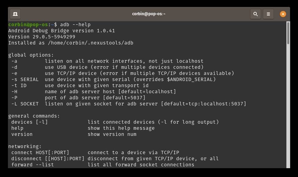

After you install ADB, try typing the command "adb --help" (without the quotes) in your Terminal/Command Line application and press Enter. You should see something like the below screenshot. If you get an error or other message, try closing and re-opening the Terminal/CMD window and try again.

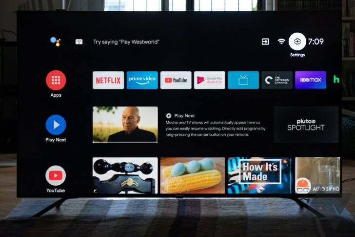

Now it's time to connect to your TV. Press the Settings gear at the top of the Android TV home screen, then go to Device Preferences > About. Scroll down to 'Build,' then click Build until you see the message "You are a developer."

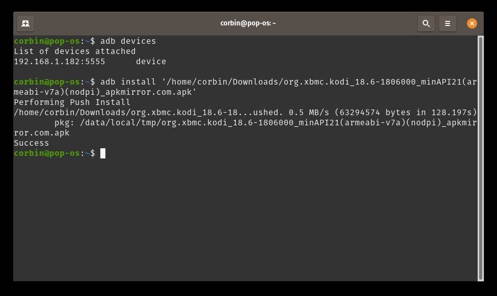

Now it's time to connect ADB on your PC to your Fire TV. Go back to your PC and run "adb connect" (without the quotes), followed by the IP address of your Android TV. This will cause a prompt to appear on your TV that you will have to accept. Afterward, you should see a message that ADB successfully connected — you can also run "adb devices" to verify.
Finally, you can now install whatever APK files you want. In the Terminal/Command Line, type in "adb install" (without quotes), then a space, then drag the file you downloaded into the app window. It should paste the full path to the file. Then press Enter and watch the magic.
If you got a "success" message, the app should now be visible on your TV. If you want to sideload more APKs in the future, all you have to do is run the ADB connect command again on your PC, then run the install command for each APK.
