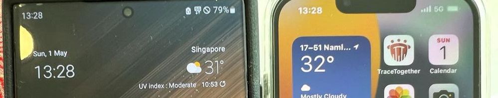

Still experiencing the same problem. My S22 Ultra on the left and Iphone 13 on the right. Both phones are side by side and on Singtel. The S22U has no signal and cannot connect to the Internet. Apple has full bar 5G and is working fine.
