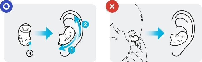

Step 1. Hold the upper and lower sides of each earbud and remove them from the charging case.
Step 2. Check the direction of each earbud and point their lower halves (speaker) in the direction of the lower part of your ear. Make sure you put the left and right earbud in the correct ear, with the speaker facing inward.
Step 3. Place the lower and upper halves into the corresponding parts of your ears, and then adjust the earbuds so they fit.
  • If the earbuds are not positioned correctly in your ears, they may not work. If this is the case, use a pair of wing tips that fit your ears and wear the earbuds properly.
  • If the touch-sensitive sensor does not contact with your ear, the earbud may not work. Use the wing tips that fit your ears if you do not hear a sound informing you that the earbud is detected.

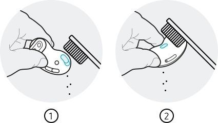

Check 3. Check if the speaker and the air duct are clean.
If earwax or debris builds up in the speaker and air duct, sounds from both earbuds may be different or audio quality may be degraded. Remove any earwax or debris with a clean, dry, and soft brush, cotton swabs, or other tools.
  • Use a soft, dry cloth to clean the earbuds after use.
  • Keep the earbuds dry. Prevent liquid from contacting or entering the earbuds.
  • Clean the earbuds regularly to prevent earwax or debris from building up in the speaker and the air duct.
