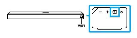

Method 4. Connect with Wi-Fi
Use Wi-Fi for a wireless connection between a soundbar and your TV. A Wi-Fi connection has a wider range than Bluetooth, and it offers multiple connections to the TV and sound system.
Step 1. Click the Source button on the back of the soundbar or click the Source button on the remote to select Wi-Fi mode.
Note: For 2016-2018 TV models, if you select Wi-Fi mode when the TV is turned on, the automatic connection method will be displayed on the screen.
