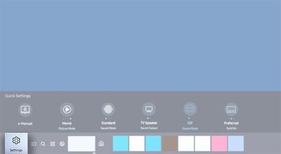

1. Press the Home button on your Samsung remote to bring up the Smart Hub and then select Settings.

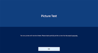

4. Scroll across and select Picture Test. Once selected, an information screen will appear stating you are about to perform a Picture Test. Select OK to proceed.

1. Press the Home button on your Samsung remote control to bring up the Smart Hub and then select Settings.

3. On the Self Diagnosis page scroll down the page and select Picture TestYou will then see a pop-up box informing you that a test photo will be shown. Select OK to advance.
