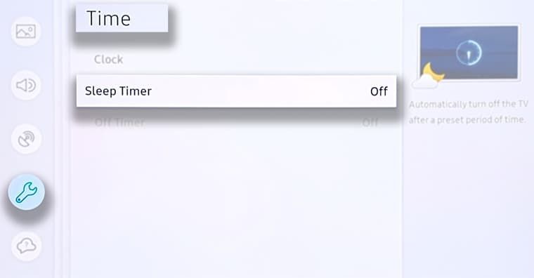

Alternatively, you can set a Sleep Timer which you will find on the same page, just above Off Timer.
1. Follow the above 3 steps until you are on the Time page and then select Sleep Timer.
2. Once Sleep Timer has been selected, choose a time from the dropdown list and press enter on your remote control to choose that time.

3. Select Time from the System Manager menu list.
4. On the Time menu list, scroll down and select Sleep Timer. Once you have selected Sleep Timer, a dropdown list will appear giving you a choice of 5 options to choose from for your TV to turn off automatically.
