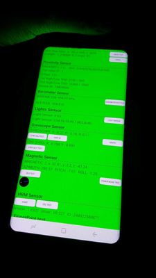

-enter service menu and test your proximity sensor to make sure its not a hardware fault. Open dial pad and enter*#0*# you'll see the screen image attached below select sensor. when blocking top of phone, screen should flash green which means your sensor is working. If you see anything else, contact Samsung for repair as its a hardware problem.

hi thank you for the quick reply, i had a look at what you asked me to do and i did manage to find all the settings, however it looks to me everything is working apart from the light sensorone, all the other settings came up as a PASS apart from the light sensor which came as level 0, which i dont know what that means, why is this happening and what does the level 0 on the light sensor option means, please and thank you , i really do appreciate it.
Jmak
Did your proximity sensor pass? That the only one you need
And your light sensor has passed too, it's used in auto brightness And camera

P.S. keep tapping back key to get out of service menu. 19da41d4-47b9-41c8-b27a-2a368ec977de.jpg

How did u get to that screen
Jmak
which screen?
