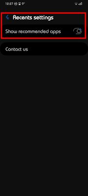

It shouldn't make a difference, but if you click on Settings in Recents (Top Right) & Toggle ON, "Show Suggested Apps" and then try to select "Keep Open", any difference for you?
