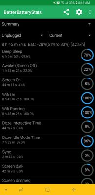

I lost 28 percent in a span of 8 hours while sleeping b4d5784f-d900-4dab-ae6b-cd5219826d44.jpg
RichMan1
same too, I get 6-8 hours SOT on my S8+. Maybe you bought refurbished phones or your phones have manufacturing problems. Go to ORIGINAL Samsung service center and change the battery.
sully
6 to 8 hours sound like a dream.
