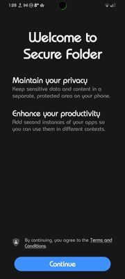

Galaxy Z
Not exactly.
The Secure Folder does not "exist" until you enable it, and the inverse is true.
I have had the Secure Folder enabled on this device, but presently it is not.
If I want to use it again, I have to effectively create it as new.
At the moment, the Secure Folder does not exist on my device, so there's no reminder when I use Smart Switch to Back it up & no request for a password on Boot.

RedDogRabbit
Galaxy Z
It's actually more than just "disabled", which is the point of my screen shots.
The Secure Folder does not EXIST on my device at the moment. It is neither disabled or present in any way.
