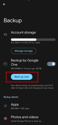

My contract for my phone is up at the end of January, so I'm thinking if my phone isn't covered, I might just wait it until I can replace it for free. If I were to factory reset the phone, how would I go about keeping the data? Unfortunately, I don't have a laptop or any other device that I could transfer the data onto for safekeeping.
RedDogRabbit
Others
I use Smart Switch to backup my phone, but you can also use Google to backup your device.
Just go to Settings & Scroll down to Google & Click on "Backup".
Like I said, if it's a hardware issue, a Factory Reset won't likely fix the issue, but if it's anything else, it should.
