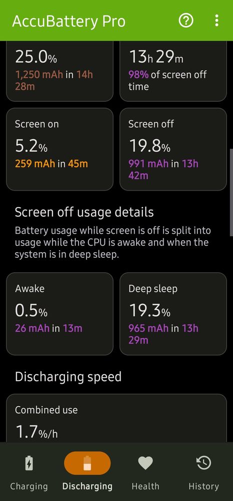

After I updated the S23ultra (918W Canadian variant) to the AWHF security patch, the phone is using an insane amount of battery while in deep sleep.
It used to burn 2-3% in 8 hrs, now it's 20 -25%...and yes, in deep sleep, no app reported running by Device Care or Accubattery.
I always do a cache wipe after these updates - didn't help.
In full desperation mode, I factory defaulted the phone - that didn't help either.
Running the phone in safe mode or airplane mode does not fix the drain.
WHAT DID fix the drain is forcing the phone in 4G mode - obviously not a long term solution.
I will add that this is happening at my house where the LTE signal as always been 5 bar (better than -95dBm on band 12) and I have not changed carriers or anything.
The phone uses normal amount of power when in use, or at least I can't detect deep sleep drain as it's not sleeping.
Looking for suggestions on how to determine if the modem code got busted, if the carrier made their own changes (is that even possible?) etc.

Galaxy SNothing, absolutely nothing. Therefore I suspect the modem, given that the issue subsides when I drop to 4G.
I mentioned that safe mode and airplane mode didn't solve anything....
BTW hope is it OK to post screenshots (I'm new here)? I have tons.
LTE off
LTE on
