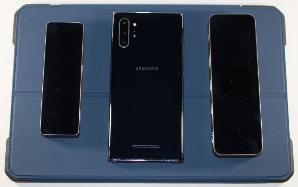

DPR91S (top) and DPR01S (bottom)
DPR01S (left) and DPR91S (right)
Both hubs have a case made of zinc alloy and tempered glass, an internal fan and has a little heft to it. Yes, it’s not really a lightweight hub, but it’s not heavy either. It’s got enough weight on it that it won’t be sliding around your desk with its rubber feet. The USB-c cord that attaches to the host is removable and not attached to the hub. This is an added benefit compared to other hubs with attached cables. First, you can change swap cables to suit your needs. Either change length and/or use USB-c to USB-A cable if host doesn’t have USB-c port. Second, if the cable is defective, you can simply replace it without the need to replace the entire hub.
They can be used powered or unpowered. However, if using unpowered, be aware that it may or may not work dependent on the power draw from the tablet to the hub to multiple devices/drives. I was able to run a mouse, HDMI out and gigabit ethernet unpowered with no major issues for a few minutes while testing. I didn’t use it for too long due to battery drain on the tablet. I also experienced an unstable USB connection when I started to attach more devices. Understandable as the power draw was probably becoming a burden for the tablet to handle.
In terms of portability, that will dependent on what it will be used for. As a simple unpowered hub, there are limitations already dependent on the power draw it will have on the host and if the host can properly manage it. It’s pretty blocky but still amazingly compact. Though the DPR91S does have a bit more heft to it.
DPR01S (left), Note 10+ (centre), DPR91S (right) and Tab S8 Plus in UAG case (underneath)

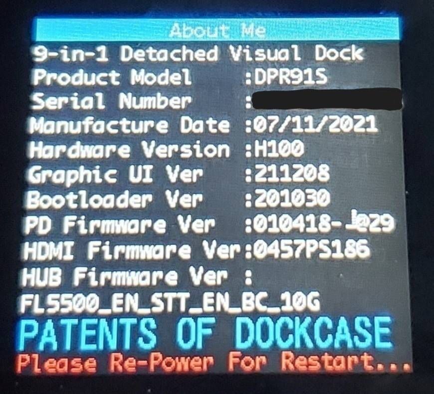

Furthermore, there is an easily accessible D-key located beside the dual card reader on the DPR91S that you press to rotate the screen. Yeah, if you need to see the screen in a certain orientation, you can simply rotate it with a press of a button. It rotates 90’ clockwise with each press. I would wait for the screen to fully load and display though. I did it quickly a few times and bugged the PD port that it couldn’t read properly and gave a reset error. In which case you needed to restart the hub. If you press and hold the D-key it will cycle the menu selection for HDMI info, PD info (both give more detailed information than what’s generally displayed and will only display for a few seconds), Control panel (for changing certain hub settings), About me (give detailed information about the hub) and CFG & DFU (used to update firmware). Yes, this does come with firmware that can be updated. Unfortunately, the DPR01S does not have the D-key. However, it does a have a pinhole with a button housed within it. The button works in the same manner as the D-key. However, the downside is it is not easily accessible and the location of it can make it difficult to get to. You’ll need a paperclip to insert into the pinhole that is located under the second USB-A port that is on the same side as the PD port.
HDMI Info
PD Info
About Me
The hub also has a temperature sensor and will display the temperature of the ports one by one in the upper right corner of the display. No need to burn yourself if the hub gets too hot as you will be able to visually see the temperature reading in real time.
Lastly, we have the control panel. This is where the user is free to adjust certain settings in the hub to suit their needs. To navigate through the panel, simply press the D-key to move the cursor. To make a change, simply press and hold the D-key until the top bar says OK and depress the key. If you continue to press and hold the D-Key you will see the bar go from green to red with Restore. This will basically restore the control panel to default (it saves time if you don’t want to scroll all the way down to the bottom of the menu to do it). I haven’t done much here except to enable the fan to cool the hub as it was becoming a little too hot for my taste. The hub wattage is adjustable between 5 to 25w. The DPR01S is defaulted to 15w while the DPR91S is defaulted to 20w. I haven’t found the need to adjust the wattage as both defaults seem to operate fine. There is a nice greeting splash screen you can enable and change as well (if you are into that sort of thing) as well as a screen saver. Mind you, you can’t change the dialogue in the greeting, just the image. Of course, the DPR01S and DPR91S will have most of the same options with some differences. Like USB battery charge in the DPR01S and USB 3.2 speed in the DPR91S. It’s also interesting to note that the DP Lane No. is greyed out in the DPR01S, but not in the DPR91S.
