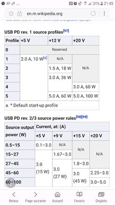

Nah, 100W is too much. Anyways, OTG devices requiring more than 15W are way past OTG-class devices. Full 100W is really for laptop extension docks over a single USB-C connection.4841b5ab-66e0-4d4a-a27a-19647e2d18c1.jpg

The 3.1 standard is designed for the 100w at 10A so I don't doubt that. How well the manufacturer may implement the standard is another thing. That's right I'm still hoping an official Samsung input would be welcome as well. I'm just content my OTG will operate without needing external power. I keep sufficient external power when I need it.... and powering a 3.5 desktop drive never entered my thoughts....
The standard for 10Gb data rate was my mission concern and 3.1 Gen 2 could be more complicated, just wait. 😊
