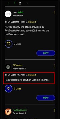

This solved the problem for the OP:
"When it occurs, you can go to Settings >  Notifications & Scroll down to see "Sleep Mode" & set it to "Silent". "
Maybe it will work for you as well.
