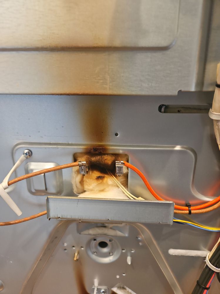

I just wanted to share an issue that I had with our Samsung stove and possibly connect with others whom have had the same experience. While the oven was on, we heard a loud pop and saw flames coming up from behind the control panel. Fortunately, the fire did not last long and there was no damage done, however, it could've been much worse. I did some research, and it appears that this is not an isolated issue with this model stove.

I contacted Samsung and they have agreed to replace the control panel, however, I am concerned that they are replacing the panel with an equally defective and potentially dangerous part. When I contacted Samsung to get more information regarding the replacement parts, I was brushed off and told not to worry. All that I am asking for is some assurance that Samsung have recognized there is a problem with these control panels and that the replacement parts are safe to use.

So Here is what we found so far! The problem with these fires appears to be the Temperature Sensor # DG32-00002B Oven Temperature Sensor Probe Genuine OEM Range Thermistor Compatible with Samsung and L...
So the problem is also in LG who has already Recalled their Ranges

If you have any model with ‎DG32-00002B temperature sensor thermistor YOU are also at risk! We found these Samsung models but check the LG models to see if yours hah this DG32-00002B temperature sensor.
Here are Samsung models including this DG32-00002B temperature sensor.

Mine caught fire this evening.  Connectors fused and I had to cut wires to remove control panel to ensure it was extinguished.  I couldn’t imagine if I wasn’t able to pull it off the wall and unplug it before it got worse.  Kids, pets, and wife were all inside.  If this has happened to more than one of these ovens and nothing was done, shame on Samsung.  I would never replace just a control panel even if it was redesigned.  My connectors fused and wire insulation was damaged.  Lives are at risk.  There should have been a recall.
