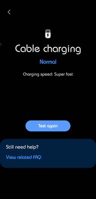

Try a different Charging Block & or Cable.
No issues with my S23 Ultra One UI V6.1 June Security Patch OTA.
Outstanding Battery life as well.

RedDogRabbit
Well, you saw the screen shot of my S23 Ultra One UI V6.1 June Security Patch OTA, and Super Fast Charging is working properly.. So if your S23 Ultra isn't, it wasn't caused by the June Security Patch Update.
Seeing as you you said that you Wiped Cache & Factory Reset.. Either visit a Samsung Service Centre to get it checked out by a tech, or maybe USB Charging Cable & Block #6 will work for you?

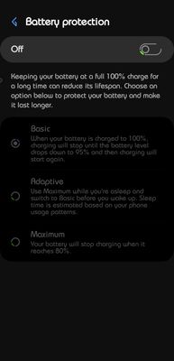

RedDogRabbit
Maybe check the Settings in Battery Protection.
There's 3 options to choose from.
As you can see from the screen shot, I don't use Battery Protection on my devices.
It's possible that Samsung's Developers decided that having a wider range, 95% - 80% made more sense to them?
Try turning OFF Battery Protection, and see if your phone will Super Fast Charge?
It's possible that Battery Protection also limits charging speeds?
