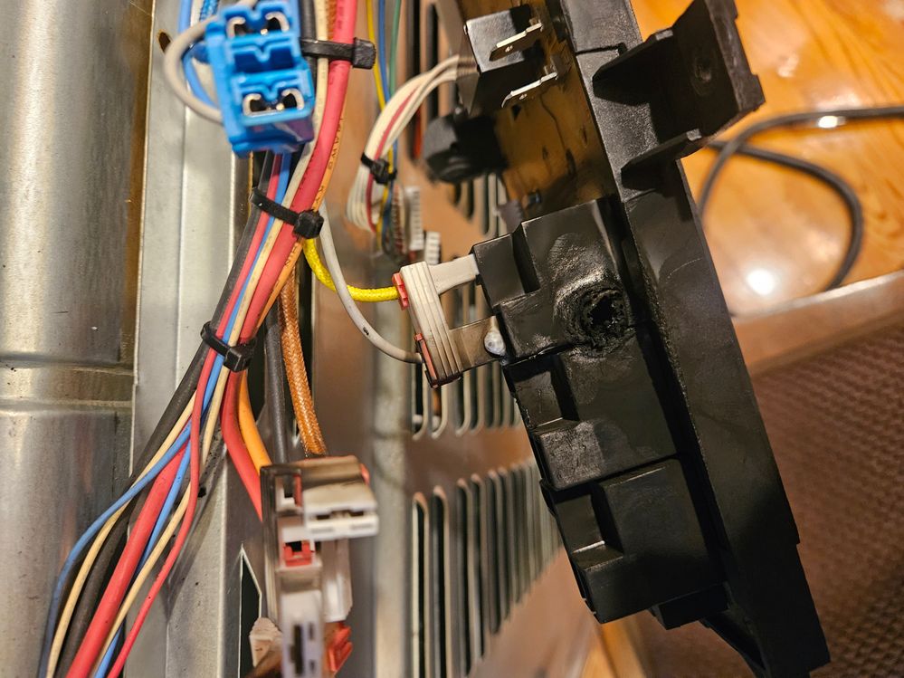

OthersSame thing just happened to our oven on September 17, 2023 while it was preheating. I heard the relay arcing and then the pop as it ignited. Seconds later I pulled the stove away from the wall, unplugged it, and blew out the small fire on the burning relay. Minor burn marks on the tile backsplash but could have been much worse. Opened the stove and found the damage in the photo below. Wish I had googled more thoroughly earlier as i bought the replacement control board and the stove is now working as it did before the fire.
