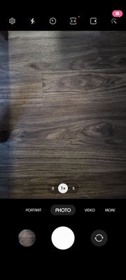

Not only does Samsung's Camera work on my S20 Ultra One UI V5.0, but Gcam & Samsung's Raw Cameras are also working perfectly for me.
