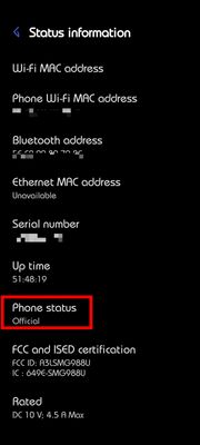

Also, if you go to Settings > About Phone > Status Information can you post a screen shot of this?
